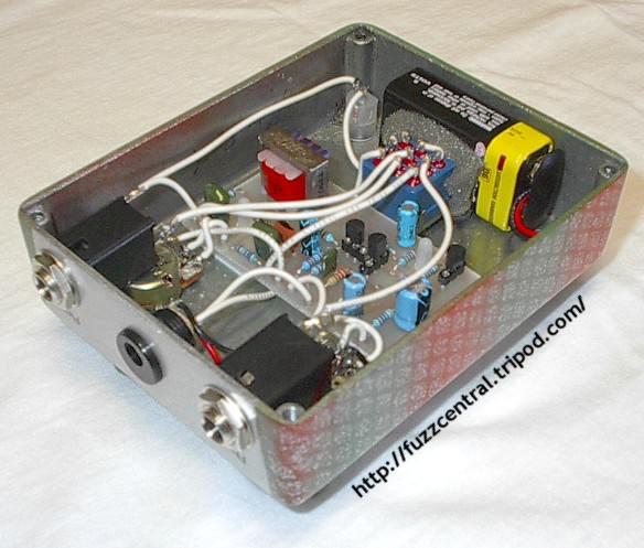

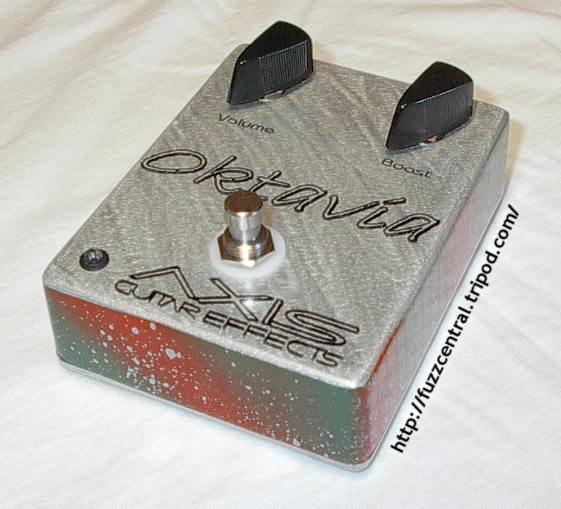

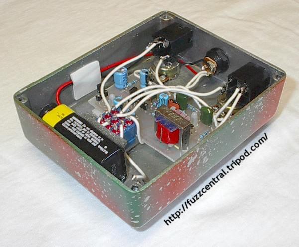

Here are some pictures of my Tycobrahe Octavia Clone. Click the thumbnails for the full-size image! Use your browser's "Back" button to return to this page.
Box Layout
Box Layout
Box Layout

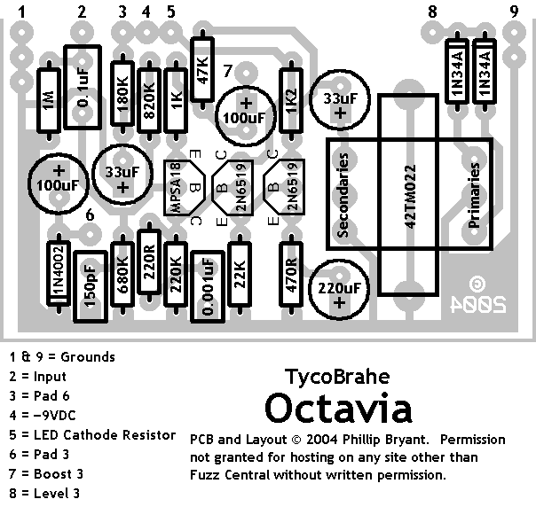

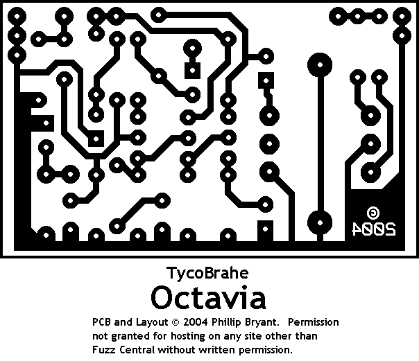

The PCB and Layout
The layout that I've included for this project is for the original positive ground version. To build it as the negative ground version that I cooked up, replace the MPSA18 transistor with a 2N5087, and replace the two 2N6519 (or 2N3906) with a pair of 2N4401. Then you'll need to reverse all the electrolytic capacitors. You DO NOT need to reverse the two 1N34A Germanium diodes on the circuit's output.
