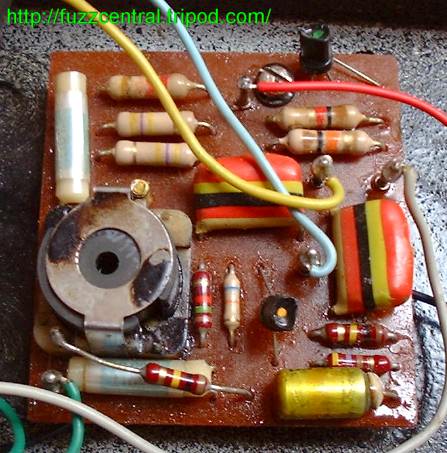

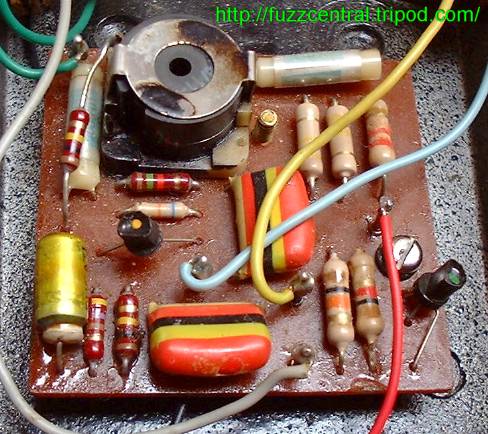

Below are some pictures of an original Vox Clyde McCoy wah pedal. In the pictures you can see the
100K resistor paralleling the inductor (one end of the resistor is soldered directly to one of the inductor's posts),
the tropical fish capacitors, and the "small hole" Halo inductor. Also take a look at this Clyde's switch in the third
picture. That's an Arrow DPDT, but notice how it's wired...as a SPDT. What gives guys? Special thanks to Stuart Castledine
for providing me with these very nice pictures!

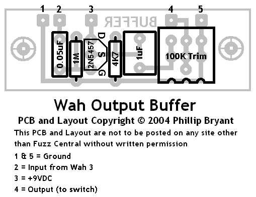

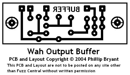

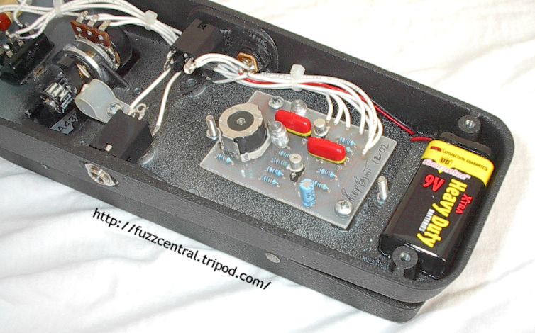

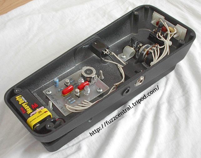

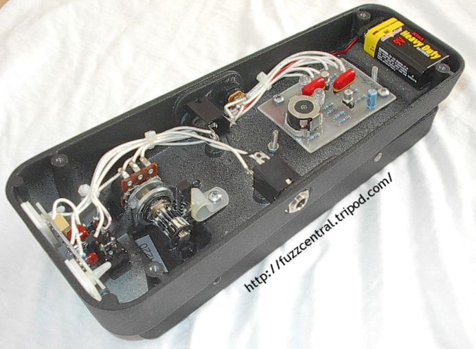

Pictures of my Clyde McCoy Clone, complete with JFET output buffer mounted at the "toe" of the case (pictures updated 4/4/2004):
A common problem is that the wah pedal simply won't wah when put in series before a fuzz pedal.
Unfortunately, this is the way it sounds the best to most people. This problem can be solved by adding an output
buffer to your new McCoy clone, which won't alter the tone of the pedal. This is a simple JFET buffer that's based
on the Wah Wah project at Tonepad, and can be added to any wah pedal that doesn't have an output buffer, namely the
Vox V847s and the Dunlop Crybabys. The input impedance of this buffer is set by the 1M resistor from the Gate of the
JFET to ground. Since this buffer can give a slight volume boost, a 100K trimpot is on the output of the buffer to
act as a volume pot so you can keep the volume of the wah pedal at the same level as when it's off. Below is a
schematic of the Clyde McCoy wah with the output buffer highlighted in red:

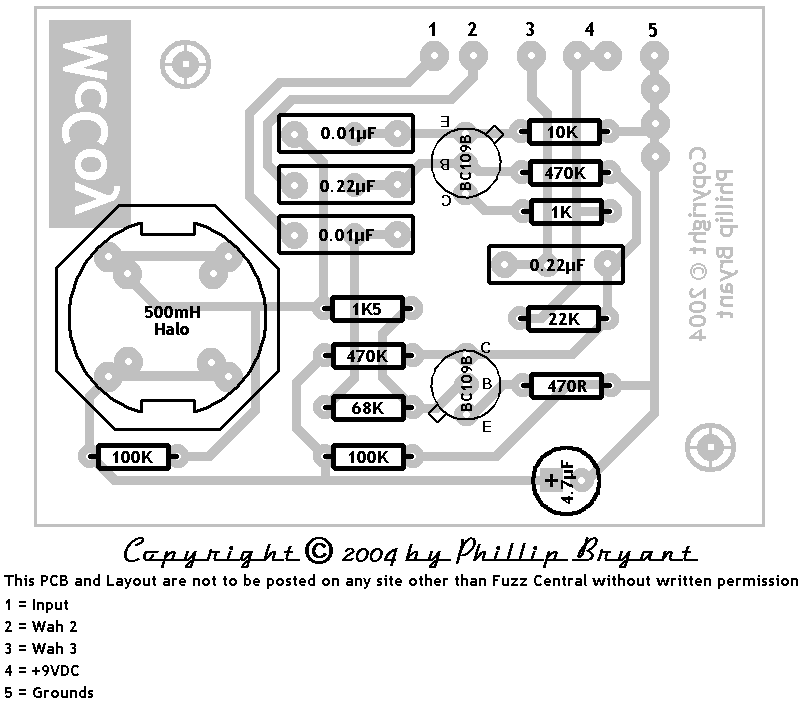

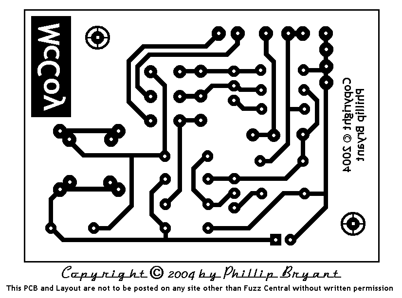

Vox Clyde McCoy PCB
Vox Clyde McCoy Layout

Build Difficulty: Easy
With the PCB and layout files you can build several different wah pedals, but as you can probably
tell from the labelling on the transfer pattern, I originally intended it for the McCoy circuit. The layout will accept
Stuart Castledine's Halo replica inductor, which has a lead spacing of 0.4" all the way around, and it will also accept
the original inductors from Crybabys and V847s, which have a lead spacing of 0.3" all the way around. The PCB and Layout for the
output buffer can be mounted just about anywhere in the wah shell. I usually stick it on the vertical wall at the
front of the wah pedal in front of the bypass switch.
