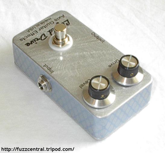

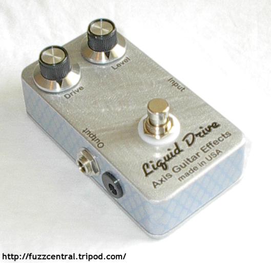

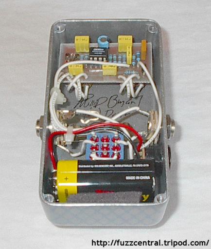

Here are some pictures of the Liquid Drive. The box was given a swirl sanded top and the sides were painted light
blue metallic (acrylic lacquer) and then a silver "snakeskin" stenciling was sprayed over the light blue. Click the thumbnails for the
full-size image. Use your browser's "Back" button to return to this page.
