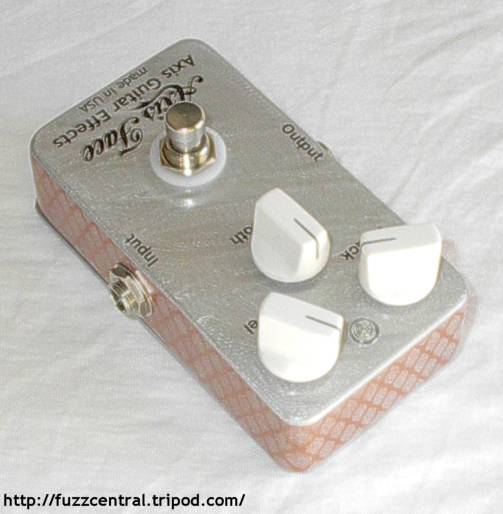

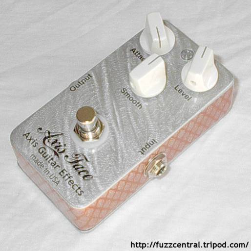

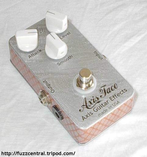

Here are some pictures of the Silicon Axis Face Rev. 3. Click the thumbnails for the full-sized image! Use your browser's "Back" button to return to this page.
Axis Face Silicon Rev. 3

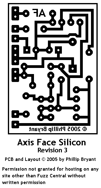

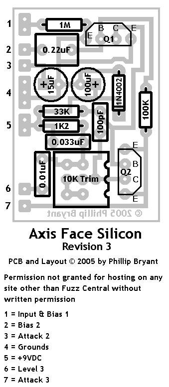

The PCB and Layout
The transistor pads in the Axis Face Silicon Rev. 3 PCB will fit a wide variety of different transistors that have different pinouts. You can use the standard C-B-E pinout and also the B-C-E pinout (like the BD139).
